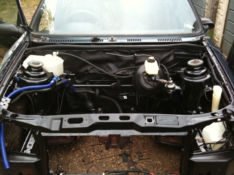

This is what my engine bay looked like after:

Of course you will never make it look completely new but it will get rid of most of the staining and as you can see from my pictures, it makes a difference. I think the correct term is tumbling.
